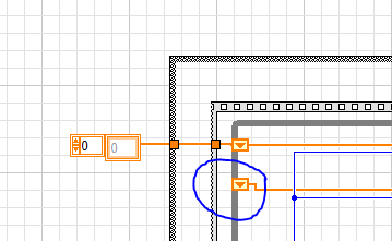

Excellent point Ben!  Not only would queues help syncrhonize the acquisition loops but the potential for race conditions would greatly decrease.  And I'm thinking there is a potential for several race conditions in that code.
Another thing to fix is this un-initialized shift register on X.  That is not getting cleared between loops.
