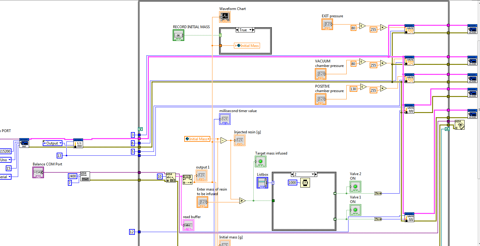

My actual VI's screenshot is attached. This is a lab project and I am controlling a set of valves and pressure regulators via Arduino and Labview. The LEDs stand for the valves in this case. I just wanted to simplfy it for you so that you guys could play with the VI and guide me.
There are 4 cases for the valves.
Case 1 = manual on/off
Case 2 = auto control (if a condition is satisfied the valves are on/off just for once)
Case 3 = This is the one I asked. The valves should be on/off for a period of time, until I move to case 4.
Case 4 = all valves are off
Now do you have any suggestions?

Thank you for the recommendation but my actual code is a bit more complicated and I need a case structure there. You can see the screenshot in the attachment.

Ok, that's even worse because now you have a race condition.
Your "initial mass" global variable is read and written in parallel, but the immediate outcome differs depending on what occurs first.
Why is this a global variable at all? Are ther other VIs that also access it? For local use, you would just use a feedback node to store the reference value.
Please attach your actual VI, looking at a code picture never gives the complete information.
Why is there so much duplicate code??? You could calculate 255/80 once before the loop and multiply the controls with the result. Why do you think you need to do that three times per iteration?
You could even use a arrays of controls/indicators.
Your code is also broken because some output tunnels are not fully defined.
Your shift register serves no purpose because you never use its output.
