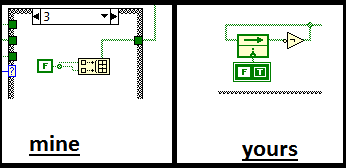

4 - In Case#2, you created a 1D boolean array and it looks nice but I cannot do it that way? How did you do that? (see the picture)asddffff.png

  4. What can't you do it that way? Drop an empty array container on the diagram and drop a boolean diagram constant into it. Set all desired elements to the desire value..
