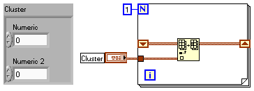

While the help could be a little clearer, it's not inconsistent. Let's try this a different way. Do the following exercise:
  1. Start with a new VI.
  2. On the front panel place a cluster of two numbers. If you like you can place your cluster typedef (just the cluster, not the array). It doesn't really matter.
  3. Place a for-loop, and wire a 1 to N, and add a shift register.
  4. Inside the loop place a Replace Array Subset.
  5. Wire the shift register left/right to the array/output array terminals of the Replace Array Subset function. So far the shift register wire is still broken. Why? Because it doesn't know what the datatype is yet.
  6. Connect your front panel cluster to the new element terminal of the Replace Array Subset function. Voila. You end up with this:
    The shift register now knows what the datatype is. It's an array of clusters. What's the default value of an array of clusters? An empty array. Which is what's being used since the shift register is uninitialized.
Now, where is the array of cluster typedef in the above? Nowhere. And that's why it has no bearing on the matter. Even if I were to create an indicator from your array of cluster typedef on the front panel and connect it to the shift register ouput (rather than right-clicking on the "output" and selecting Create->Indicator), it would not change anything.
