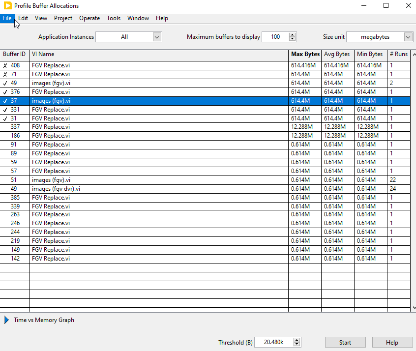

The reason the FGV Replace (NON_DVR) is so slow, it appears LabVIEW is making multiple buffer allocations with that method. If you look at the "Profile Buffer Allocations" Tool you will see lots of buffer copies of the data. I believe that is why it is much slower.

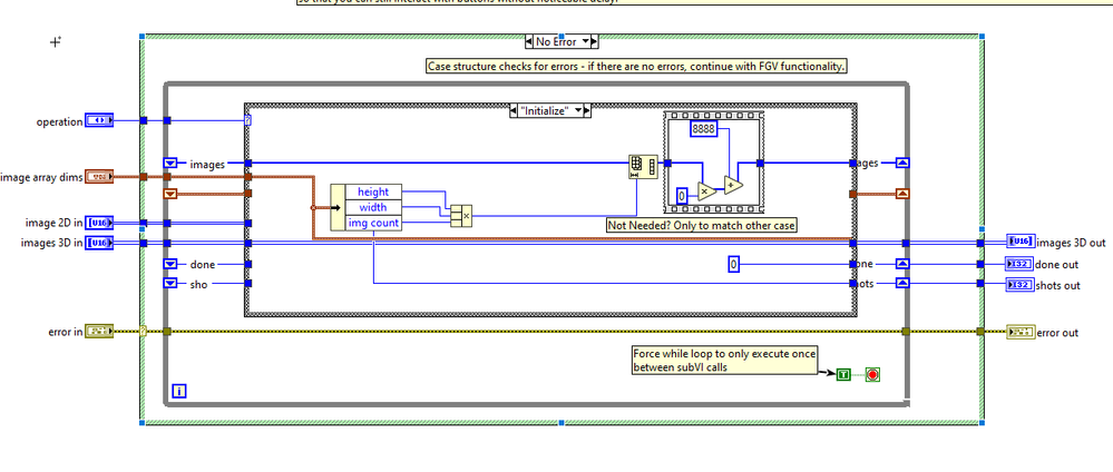

Some quick mods on my computer and DVR case is now slower. VI is attached, below are the mods.
The region below in the sequence structure is not needed; it was only to initialize your values to 8888 so the equals works. You can keep if desired.
No need to reshape the array
For my test I included the DVR creation, like in my earlier reply.

I like the idea to use reshape instead of initing the array in the "reinitialize" case.
I also like to use rowise replacement instead of reshaping 🙂 very nice.
