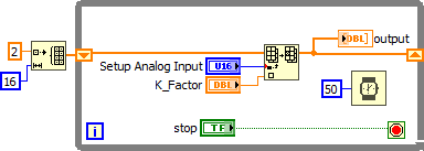

i need to change values of an array with 16 elements. Using an array control looks really bad. So i thought i can make it with an menu ring. I tried to use the menu ring value as index to change the corrosponing value. That works. But when i change the the ring element, the changed value isn't stored in the array an the initial value is restored.
I attached a minimal setup.
Maybe some of you guys can tell me whats wrong with my program.
Thank you.

You always start with an empty array with each iteration. If you want to operate on the updated array, you need to keep it in a shift register. Very basic stuff.
Your loop also needs a small wait. No need to spin millions of times per second.

Here's how it could look like.
Note that your index array was pointless. If you want two modes (replace current, read current), you should use a case structure and two states.

Thanks for your help. I implemented the case structure too.
