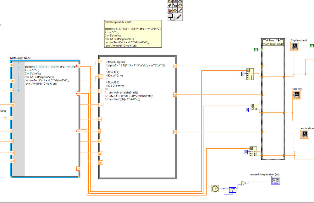

Good people. I am new in LabView. I wrote a program using the Mathscript node but the iteration time is 200ms. I need something faster than this. My understanding formula node will be faster than the Mathscript node. Here I am attaching my VI.  I tried this to convert the formula node but faile. Can anyone help me to convert this VI to formula node?
Thanks.

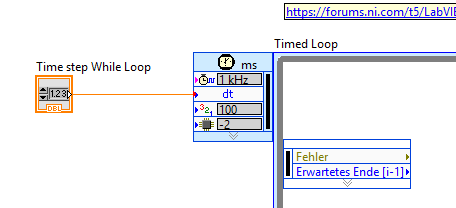

You have set the iteration time of the while loop to 200 ms each iteration here:
decrease this value e.g. to 1 ms, and see what happens next...

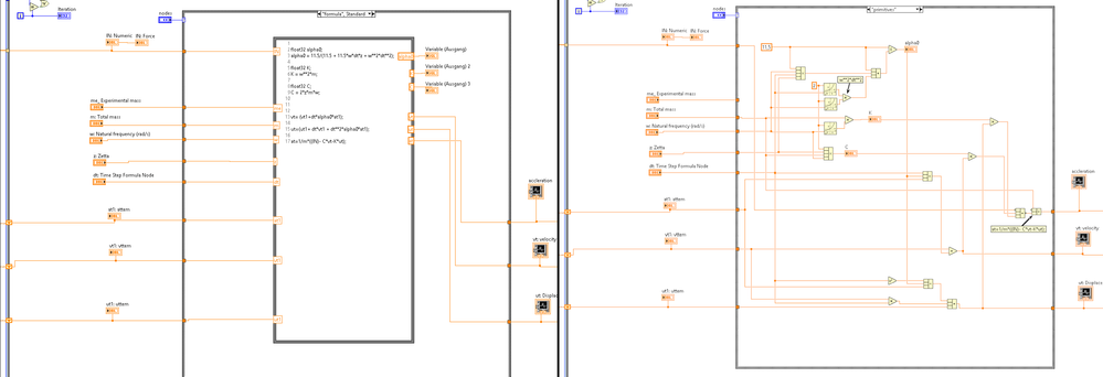

in the mean time, your mathscript node can be re-written as:
(test4_formula-node.vi)

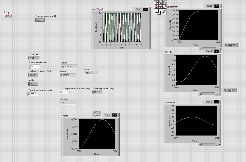

without the mathescript-node, I can run the test4.vi and this is what I get on the frontpanel: (test4_no-mathscript.vi)
