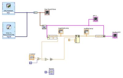

This is what I have so-far ...
Making the "insert into array" dynamic in relation to multiples of "n" and making the "insert into array" variable lenght (j as in my example) is where I'm at
Attempt_1
Message 5 of 23
(7,522 Views)

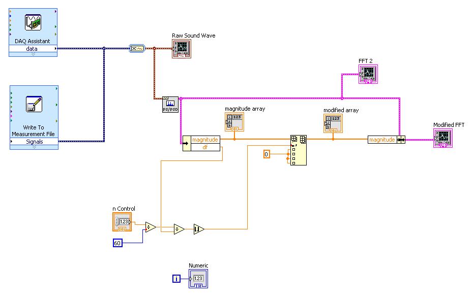

Image came out abit small so ...
Attempt_1
Message 6 of 23
(7,520 Views)
First, that is not a VI; that is a graphics file.
Second, since your problem is that you don't know how to process the 1D array, why are you throwing all that extraneous stuff in your program?
Start with a simple VI with an array of constants and see if you are able to come up with the algorithm for processing that array of constants.

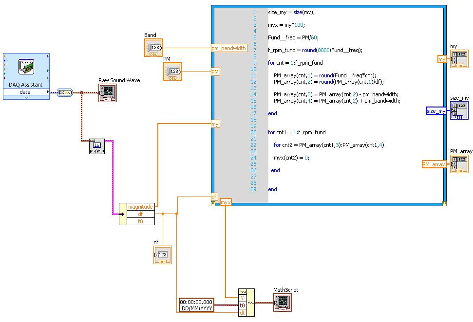

Ok,
After many attempts to manipulate the arrays I couln't get it to work so I ended up using mathscript to do the job:
Mathscript Solution
In terms of using the labview functions I got to the point where I can insert any array of size j at any location n. To insert the array of size j at multiple locations at integer multiples of "n" I'm still having difficulty with.
I really would appreciate some guidance at this point, I have the mathscript solution working and would really like to know the "labview solution".
Attached is the VI.
I have been fishing for the day ; )
