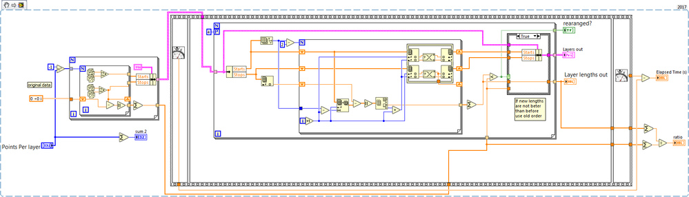

@tshurtz wrote:
Try3.pngTry3.pngThanks again!

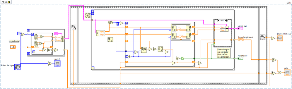

There is still a potential optimization here.
Note how the inner loop does a lot of work. Then all the results are added, and if the result is bigger it's not even used!
So in the inner loop, we can add all the distances in a shift register. Then we can conditionally stop the loop if it gets too big. The add after the inner for loop can be removed.
(NOTE: Completely untested! Also not sure if it even is faster!)
rearange2013_MODCA_4_parallel_InnerFaster.pngrearange2013_MODCA_4_parallel_InnerFaster.png
My benchmarks go all over the place. First run 38 s. Then removed the swaps: 38 s. Restored the swaps 70s. Removed swaps 38... I worked from an untitled VI, and sometimes saving the VI makes a difference.
Message 48 of 53

wiebe@CARYA wrote:
@tshurtz
That's one of the things I tested early on and it might work better with real data. With the random data, early stops seem to be rare. OTOH, checking for early termination with every iteration causes more overhead and slows down each iteration.
Message 49 of 53
(2,483 Views)
@altenbach wrote:
wiebe@CARYA wrote:
@tshurtz
I agree. Could not make any difference. Guess OP has to check with real data.
Any thoughts on the swap? Can we be sure it compiles to a NO-OP? The swaps are a (tiny) bit cleaner, but I'd default to swapping the wires. The performance difference might be in the noise margins...
