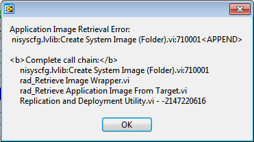

I work with mdmorar above. To give a little bit more information.
When we try to rerieve an image from a cRIO we get this error:
I CAN retrieve an image from another cRIO without getting any errors. I looked up the error code and it stems from The System Configuration API is not installed on the specified target.
Here is a screen shot of MAX showing the two cRIOs and the software installed.
The first image is from the working cRIO
Working cRIO.pngThis cRIO can be imaged.
Here is the non-working cRIO.
NonWorking cRIO.pngThis cRIO can't be imaged.
Why can't we pull an image from both cRIOS?

Looks like some sort of incompatibility between versions? You have a newer version of both the cRIO and System Configuration software on the non-working cRIO, versus the working one. What version is installed on your computer? I wonder if they need to match, or maybe you need to rebuild the Replication and Deployment Tool with the newer version. That's a guess, not a definitive answer.

The computer has 2013 DS1 on it which is closer to the non-working cRIO than the working one.

It has been rebuilt as he said with LV2013 DS1.
