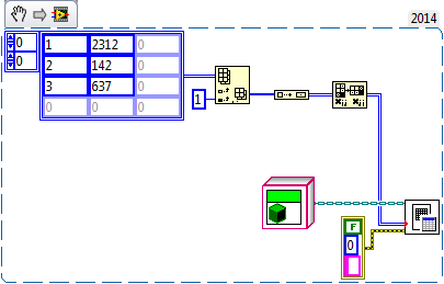

This will paste only the second column into Excel (as a column).
(4,500 Views)
So that was my mistake. The data is exporting as a 1D array, so this method doesn't work. The 1D array connects to the MS Office Report but in the report, the data comes in two columns (one of sequential data labels, and one of the actual data).

If you want the arrays right next to each other, you can build them both into the "build array" function so you only write to the Excel sheet once.
