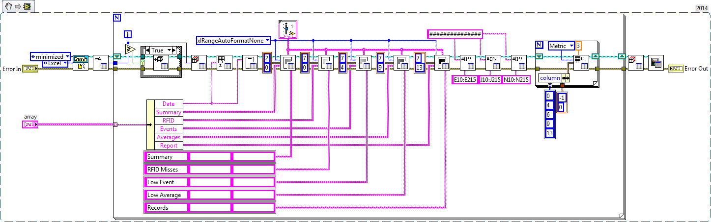

He's not opening the report over and over, it's just operations in series:
Cheers

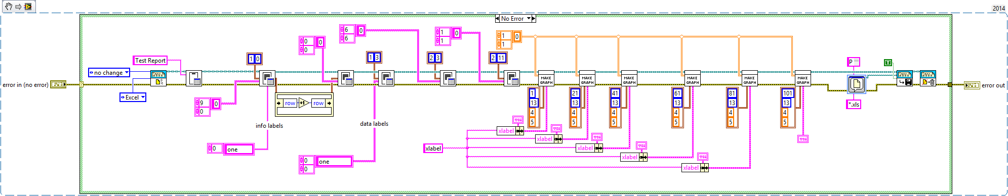

Then I'm quite confused unless it is specifically the generate graph function that is causing the window to flicker in and out becase using the below code I can run and have the window not appear until the very end program completion. Have you tried narrowing it down to what exactly is generating the flickering? From your phrasing it sounds like you suspect the entire report generation toolkit but that does not seem to be the issue. What version of excel are you exporting to?
