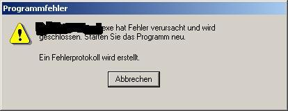

I create an exe file on  a PC where Excel 2003 is installed. On a Notebook, where only Excel 2000 is installed, the application crashes at the generation of the report:
20427iC6E35945229A2D50
I guess the problem is the different version of Excel but I don't know. On the developer PC with Excel 2003 it works fine.

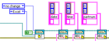

I'm using it that way:
20429i163C7B9F070E371B
