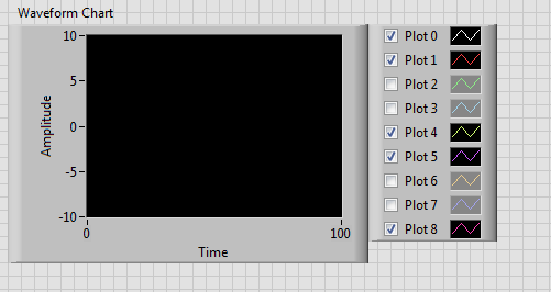

just check this image. you can understand clearly.

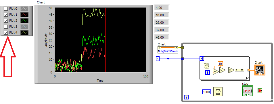

@govindsankar wrote:
Since I am the user and not the programmer, I should able to work on the inputs and not on the waveform chart.
The visibility checkbox is for the user, not the programmer. Have you tried?
The code you have posted earlier is plain silly and shows a basic lack of understanding of dataflow. Your FOR loop will run exactly once before the while loop and then the while loop will continuously show the same data over and over. Changing the numeric at runtime does not do anything. If you want to update the graph with new data, the FOR loop and numeric control belongs inside the while loop. (It is also extremely annoying if you maximize the front panel and diagram to the screen. Why would you do that??)
So we have two different problems and it is still not clear what you want:
  1. Do you have a fixed number of traces, but want to be able to hide some of them at run time?
  2. Does the number of traces actually change because the acquisition changes?
For (1), the visibility checkbox is all you need. For (2) we need more information, for example what is the maximum number of channels, etc.
Note that your array indicator is pointless. Charts have digital displays that you can show.
Here is a quick rewrite using the visibility checkbox. See if this is sufficient. If not describe one more time what you want to do. Where does the data come from?
Message 13 of 25
(2,116 Views)
