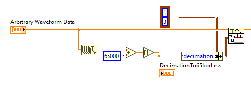

Yes as you said the best option is to use the rational resample, here you have an example how to use it:
input array +200k samples, re-sample goal 65k to load it into arb waveform generator.
