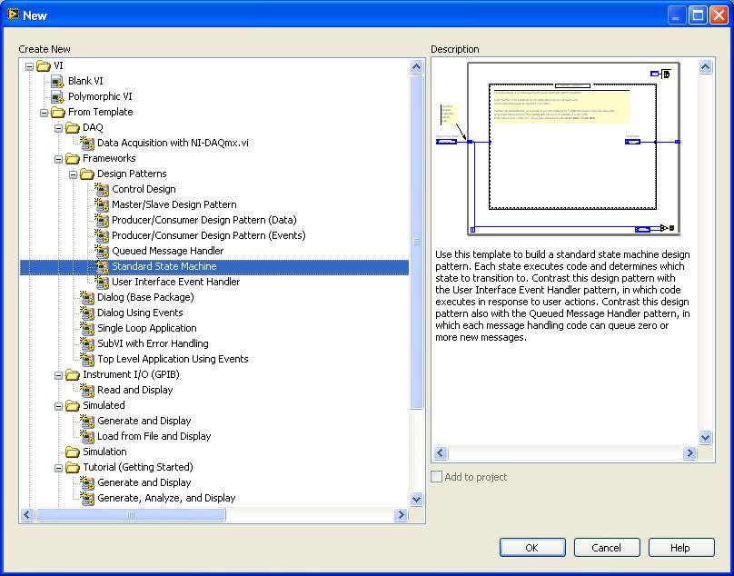

You should start having a look at the State Machine Design Pattern (File -> New.. and look in Design Patterns).

Hi Adnan,
Thanks for your reply. Could you please be more specific. Where can I find 'State Machine Design Patterns'. I presume they must be in Labview examples but I cannot find them?
Did you feel this is specific? Smiley Very Happy
