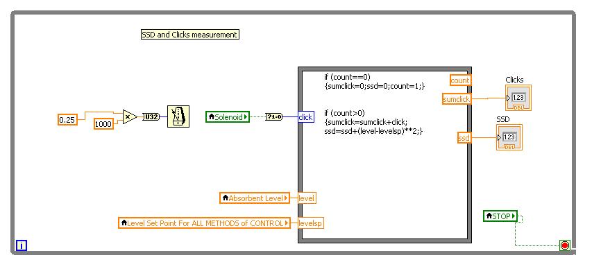

I am trying to use counter variable "count". The default for "count" is 0 when the program is opened up. I initialize ssd and sumclick to be 0. However once it goes through the formula node, the value for "count" changes to 1 and then the decision loop within the formula node that checks if "count>0" is used.
My problem is, if I stop the program and then rerun the program without closing and reopenign the program, the value for count continues to be 1, and so my intialization for ssd and sumclick dont happen. Whenever I hit the run button I want count to be 0. I dont want count to remember the 1 from the previous run. How can I do this?
The VI is below.

Add a shift register to the while loop, then add a "count" input to the math node. wire the count output to the right shift register, then wire the left shift register to the count input. Finally, add a zero constant outside the while loop and wire it to the outside of the left part of the shift register. Or post the vi and I'll mod it for you.
