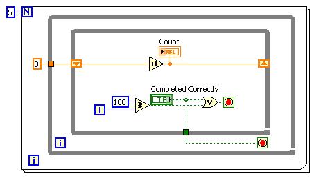

Well first of all, if you are going to restart the loop with the same program inside it after it got stuck is it not just going to get stuck again creating a permanent loop in the code? Would you not just want to move on and have some sort of identifier that one of the for-loops got stuck?
But I would recommend simply nesting your while-loop inside of another while loop, then connect the exit for the out while-loop to some variable from the inner while-loop, so if the optimization did not occur properly then it simply repeats the inner while-loop.
Although I stick by my thoughts that you will just end up in a permanent loop if the optimization fails the first time.

Thanks. I nested my while loop inside a while loop and that worked.

My optimizer initializes randomly for each trial. So if I re-initialize the optimizer, the chances are that the optimizer started at a better spot and moved progressively towards a solution.
I used your idea of nesting the while loop inside another and this helped solve my problem!
Thank you so much!

Since the max number of iterations is fixed and known before the loop starts, I would use an inner FOR loop, avoiding the constant checking of the iteration terminal. Show the conditional terminal to stop early.
(5,926 Views)

Apologize for the delay. But thanks for the comment. I tried out the inner FOR loop method and works fine for me.
