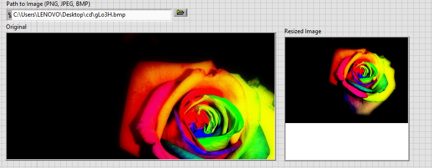

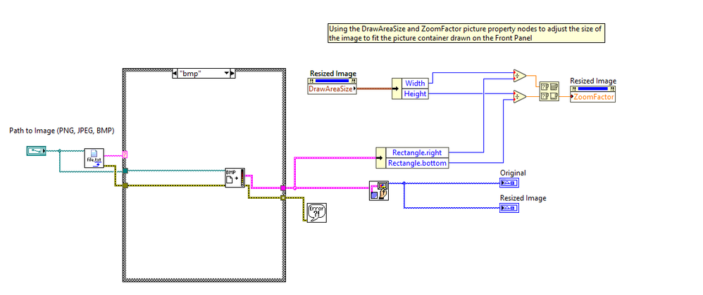

 i want to Know how to Resize Image to match the  Container Using LabVIEW ? i use the code below but i find blank space in the picture .

to "fill" your image indicator you would need to apply two different scaling factors, for both X and Y axis: this is not supported for the image indicator.
You would need to scale the image on your own (or use an external 3rd party tool like imagemagick)!
(3,551 Views)
Your code HAS matched the container WIDTH. If you want the white space below disappear, adapt the 2D picture control height.
I suggest you do a search on "labview image resize" and "labview .net image resize" for some more info.
