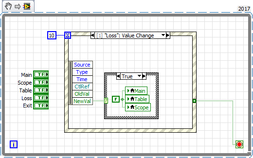

Hey I finally found a use for the Event Structure!
My first time ever... So be kind 😛

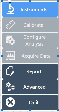

Not related to your code, but original question. Check out DMC
 => (It's Free)
You can get Radio buttons that look like this, and are resizable, it's a good target for a touch screen. I have added individual decals in the past to the buttons.
mcduff
 EDIT:
Here's a customized version of the control.

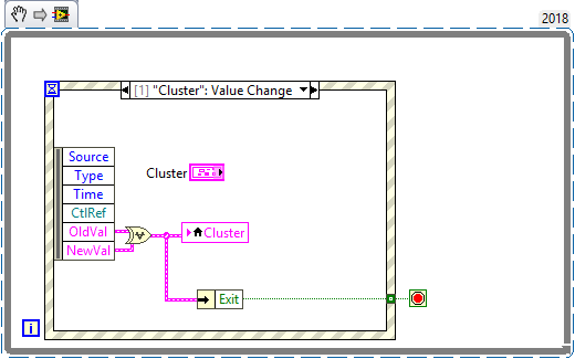

Since CA can't post code, I'll take advantage of his do more with less motto. Smiley Wink
If you put all of your booleans in a cluster, then you can do the following:
mcduff
Similar to my ancient code, but "not equal" would do the same as XOR, but be less cryptic. Also try to add logic for "allow no selection", ie pressing the active element would turn all off.
Also, that was before the event structure...

I seriously did not see your ancient code, but am not surprised that you already solved the question before it was asked. Smiley Very Happy
You are correct that it is missing logic, like no selection, etc.
