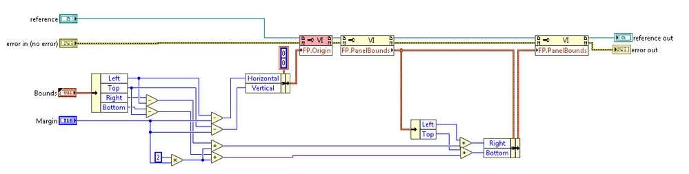

Regardless, I just avoided it and used the bounds from each control (minus selected controls) to determine an origin based bounds which I then pass into a vi that resets the VI origin and adjusts the VI bounds (Almost identically to the OpenG Fit VI window to Largest Decoration.vi but for controls plus decorations plus user margin).  Resetting the VI origin is the key to avoiding those extra pixels from the VI TotalRect property.

I was shooting for the following:
Able to expand and contract when controls are resized programmatically
Able to selectively choose what is included (EX: Switchable between 'development view with error indicators' and 'user view')
Working pretty well 🙂
