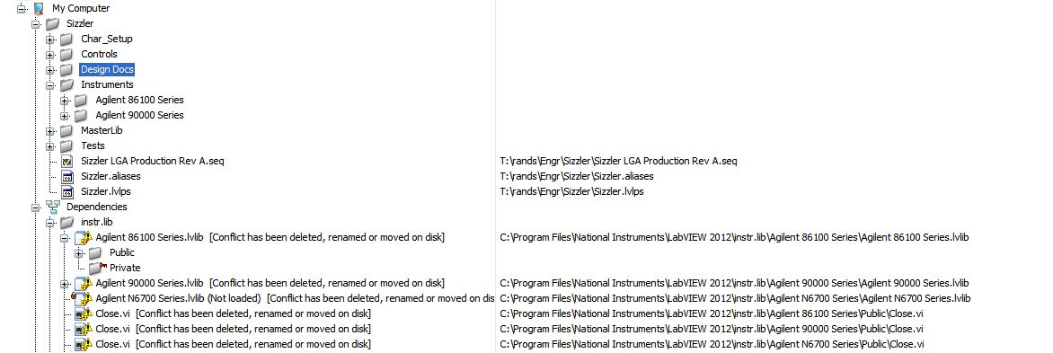

Let me share some screenshots:
The first of several conflicts is the Agilent 86100 Series.lvlib conflict as shown in the Project Explorer window.  The path shows that the file is located on the C: drive.  In fact the file does not exist at the specified path.
Project Explorer Conflict

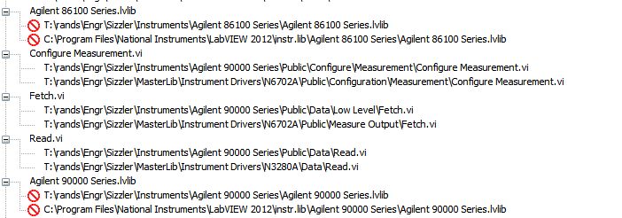

Then using the Resovle Conflict dialog I get this screenshot, which shows the conflict is the same file showing up on the T: drive as well as the C: drive.  The file does indeed exist on the T: drive, but not on the C: drive.  The problem is that I have no options for removing the C: drive reference from the project.  All options are either not there or grayed out.
Resolve Conflict

Sometimes you have to solve "sub-conflicts" (for lack of a better term) in order to resolve other conflicts.  From your screen shot, it looks like you can resolve some of the conflicts.  Once you get those resolved, maybe you can resolve the others.
(5,147 Views)
Thanks for the reply.  Your solution is basically what I ended up doing.  I had to go through each of the conflicts finding the calling VIs and then replace the conflicted sub-VI with the correct one.  This eventually fixed most, but not all of them.  At least my project now loads without errors.  The ones that weren't resolved were the ones with the red "no" icon.  The conflicts seemed to have been introduced when I updgraded to LabVIEW 2012.  They were not there before that.  Further, I am not the only one to experience this.  I work in a group of 8 test engineers, and everyone of us that has upgraded to LabVIEW 2012 has experienced the exact same problem.  The path to fixing the conflicts is slightly different, but always very time consuming.  It took me the better part of a day to clean things up so that my project would load without errors.
