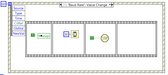

Hello All,
is it possible to restart VI with a button/value change...?
For example, I want to press button, and my VI should stop and start again immediately...
I tried this way, but I don't know how to start it again...
Can someone advise please...
Best regards.
Milan

Not really.
But you can use a State Machine and go back to your first state with a button press very easily.

OK, I will try with state machine...
I will get back to you..
