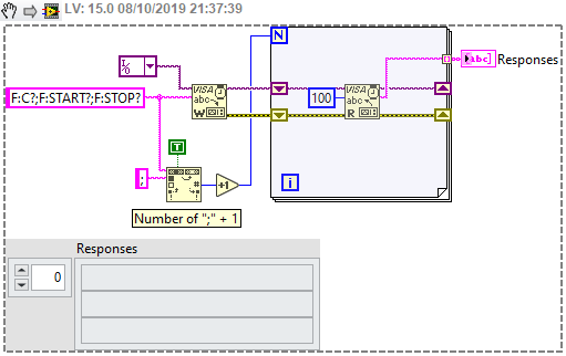

Something perhaps like the following (with appropriate setup and close VIs before and after):
You can just wire 3 if the input string is a constantYou can just wire 3 if the input string is a constant

@mctnnn wrote:
Can explain further what you mean and how to do it with Read mulitple time?
You need to perform a read for each query you sent.  So perform 3 reads.

Thank cbutcher,
your design looks more professional one.
I try and use it.

@mctnnn wrote:
Thank cbutcher,
I try and use it.
/mctnnn
I mean, I'm flattered, but just remember that adding "professional looking" stuff isn't as good as not adding any stuff. So if you create a VI that uses these 3 commands all the time, and never changes the written string, then just wire a constant 3 instead of doing the string search.
The string search is useful if you might have an arbitrary number of commands concatenated (and you don't have a way of knowing how many from when you concatenated them, which you should). So I don't anticipate it's likely to be necessary unless the "message building" part is separated from the "visa writing" part by a 'module boundary' etc (software engineering, not LabVIEW term), and you don't want to also pass an integer into the Write/Read function as to number of Reads needed.
