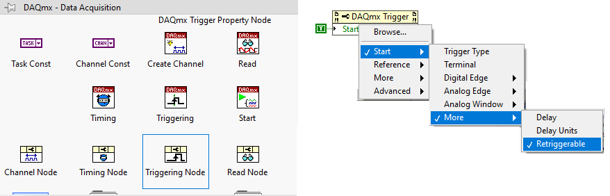

Try using the Start.Retriggerable property via a "Triggering Node".
You probably don't need to loop through Start/Stop cycling given the finite samples.
Copying from the help for the property:
Start:More:Retriggerable Property
Short Name: Start.Retriggerable
Property of DAQmx Trigger
Specifies whether a finite task resets and waits for another Start Trigger after the task completes. When you set this property to TRUE, the device performs a finite acquisition or generation each time the Start Trigger occurs until the task stops. The device ignores a trigger if it is in the process of acquiring or generating signals.

I tried this solution but I cannot see any "start.retriggerable" in the "DAQmx trigger" property node !
Am I missing something ?

Should be under Start > More  > Retriggerable
Edit: Highlight the right node...

Great, thank you for the screen shot.
It is clear now.
What I find strange is that this "retriggerable" property does not appear if I use a generic property node connected to the Task wire and select the DAQmx class.

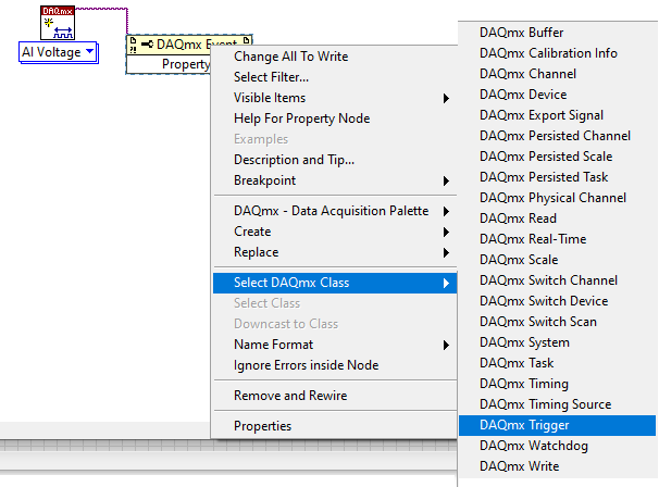

So if you connect a normal property node to a DAQmx task wire, you'll need to right click on the property node and choose (in this case) "Select DAQmx Class" > DAQmx Trigger.
There are about 15 classes you can choose from, each having different properties available. Sometimes it takes a couple of guesses to find the right one if you don't already know/remember.
The default when you connect a generic PN is "DAQmx Event", which is basically never what I want...

Yes, this is exactly what I did...
I will send you a screenshot next week when I will be back to my office.

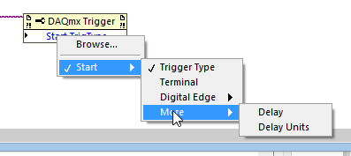

So I took the screenshot of the "DAQmx Trigger" node and as you can see it shows much less options as yours, and in particular I don't have any "Retriggerable" item under "Start>More>".
I found out that LabVIEW is filtering out the results depending on the device connected to the computer.
So it means that my USB-6001 card does not support the "Retriggerable" option.
So we are back to square 1 : what should I do to rearm the trigger ?
Since my test with "starting-stopping" the task does not work, I don't see how to do it.
Personally, I can not believe that this DAQ card can only trigger once... this would not make any sense.
I would appreciate any help.
