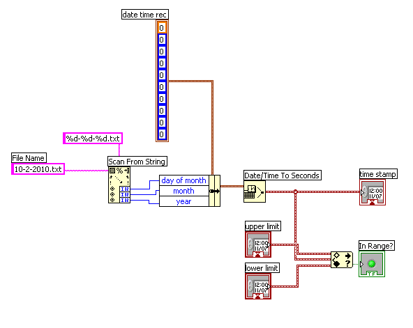

what you could do is the following:
1) Get a list of all filenames
2) Check one by one the file names if they are in the proper data range (see picture)
17729i8EE8B32D198C054B
3) Build an array of filenames in range
