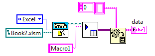

Assuming this is your VBA code in a workbook called Book2.xlsm:
Function Macro1()
    Dim StringArray(1 To 2) As String
    StringArray(1) = "Test"
    StringArray(2) = "Test3"
    Macro1 = StringArray
End Function
This Labview code should run and return an array with those values.
aputman
(4,391 Views)
