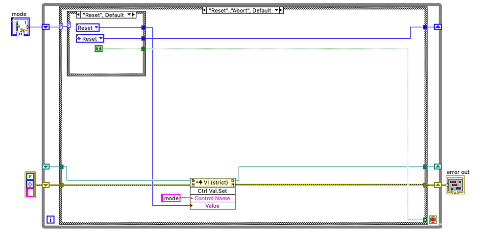

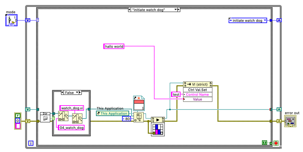

In my simple application I start a VI that is running on it's own. From time to time I do set a parameter which resets the timer on that VI. At the end, I set the parameter again and wait the VI to shutdown.
What I don't get is, I can set parameters right after I started the VI (image 1), but when I use the reference later again the address of the reference is still here, but the reference is not valid anymore. Any ideas? Any help is appreciated.

Hi Adrenalin,
there's a coercion dot…
To get more detailed answers you should attach code, not just images of code (hidden in a spoiler)!

How is this global/AE being called in your code? LabVIEW closes references that were opened once the hierarchy in which they were created stops. If you are opening the reference in one hierarchy that stops, then attempting to use it in another, the reference will be invalid.

@GerdW wrote:
Hi Adrenalin,
Check all of the cases to see which one is stepping in the reference in the Shift Register.
The other thing alluded to by Paul is when the VI that opens the reference goes idle, LV cleans up anything that was left open. So that VI you showed us either has to be in a VI that stays in a running state or that VI that you are running has to open a reference to itself to keep it alive.

Why do you have coercion dot in initiate case? Does reference links to VI with different connection pane in other cases?

Hi Ben,
You're right, this is the issue: The caller vi runs through it's code and then it stops and close it's front panel. It memorizes the reference to the watch-dog vi by the shift register. This is different for the watch-dog vi. Once started, it runs the whole time and just at the very end, I'll send an "complete" command that let the watch-dog shut-down and close it's front panel.
Now that we know what the problem is, how can we fix it? Do I need to establish a reference to that vi every time, or is there a way that the reference in the shift register remains valid?

@Sapiophile wrote:
Can someone help me how I could have a VI starting another VI and then let the first one stops and the second continue to run?
When the main VI stops running, the reference to child VI is invalidated. That means there is now no more reference open to the child. So it will stop running. The child needs to open an explicit reference to itself. Not a "this VI" node, but an Open VI Reference. That reference needs to be not closed until the VI should stop.

Hi wiebe,
Thank you for your reply. So you're saying, that in principal, I have to acquire a VI ref exactly the same way in VI B as I did in VI A to call VI B  (like: this application, open vi reference, strict typed vi reference, option x80) and then I keep that ref in a shift register until I close VI B I close it with a close ref. I tried, it was running, but I got 2 different references for the same VI A. Without a valid VI ref of VI B, how could I communicate with it, how would you establish the communication between Vi A und Vi B?

wiebe@CARYA wrote:
Huh? Why would the child stop running just because the caller stopped? It was launched asynchronously, it will keep running unless the caller (or something else) explicitly stops it.
Adrenalin - your VI is stopping after 30 seconds because that is what it is coded to to - you have a 30 second timer that elapses and then stops the loop. If you want it to keep running, don't stop the loop! Similarly, if you want to keep communicating with the VI from your launcher VI, don't stop your launcher!
Also, you don't need to use VI server to communicate between two VIs - LabVIEW has many other built in communication mechanisms - queues, events, notifiers etc. Again, each of these is reference based, so you will need to keep the VI hierarchy that created them active or the reference will be closed.
