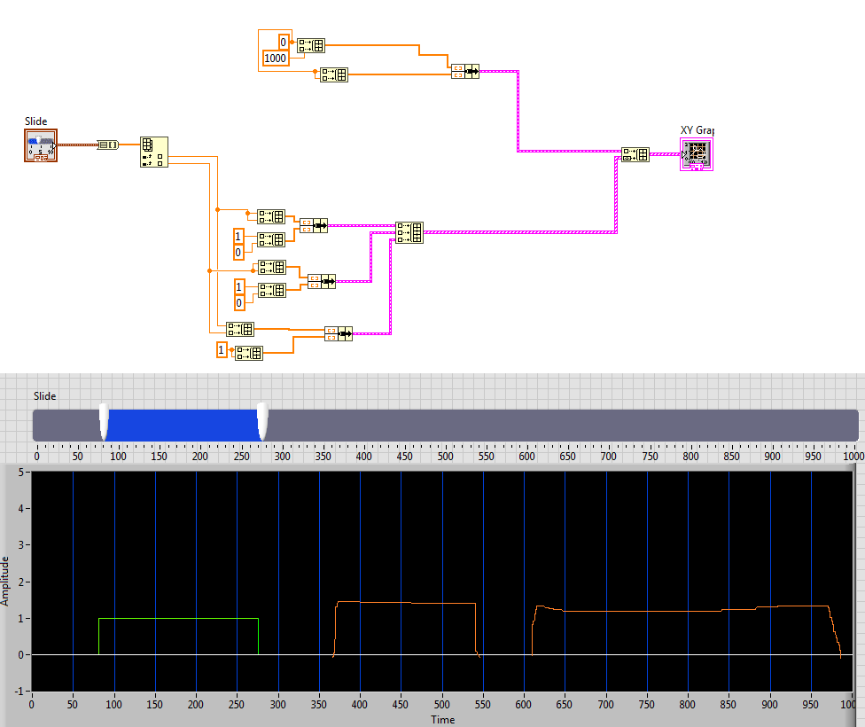

how i can sum different array for build other rectagnels?

something like this?
Message 2 of 12
(5,460 Views)

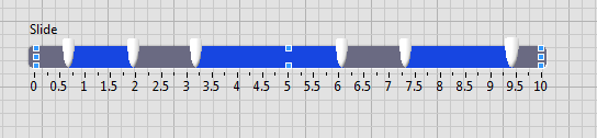

 THX but no.. i Need just one controller and one Botton for Save
Message 3 of 12
(5,448 Views)
Just keep adding sliders.  Set the first one to "Fill to Value Above",  second one to "Fill to Value Below",  and repeat.

Aputman with this solution i cant add  endless rectangles afther the compilation.. THX for the support
Then you should have made that clear in the original post.
Sliders can be added via invoke nodes during runtime.  I'm not sure you'll want to add endless sliders....may be a bit hard to read.

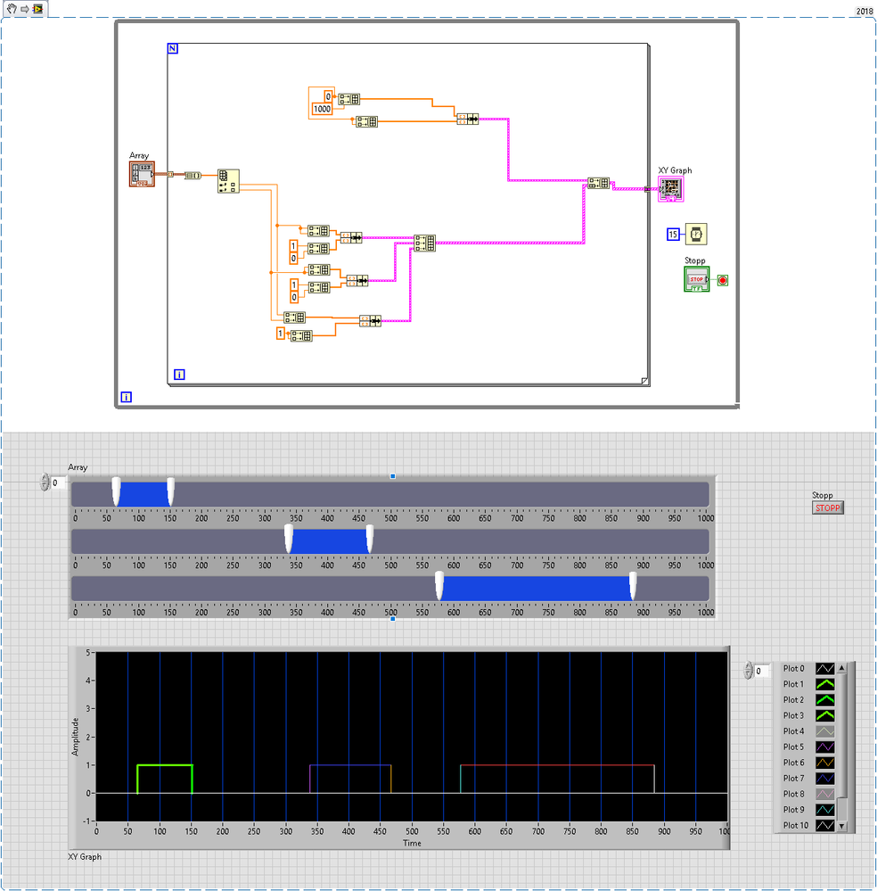

If you are always going to add a rectangle, could you use an event structure in a loop and add a rectangle (specified by the slider control) every time they click a button?  Then use shift registers to carry the existing rectangles.  Also, you should not need so many plots - even one plot should suffice unless you need different colours.  You may be able to change the interpolation style to suit your needs better.

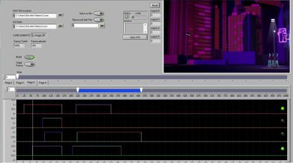

You are a genius, but I do not know how to realize your idea, if you have some time, you could send a vi demonstrating how to do it
a picture can make you understand what I'm doing.
thank you 🙂

Accepted by topic author Diell.it
It is just an example of what you could do. You will need to add functionality to it, for example to remove one or start over, or to have different channels like you have.
