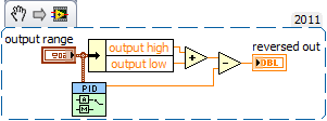

Hi Wesley,
when you need this "reverse acting" with functions from PID toolkit then you can very easily implement that on your own!
After all it's just simple math: to convert values from 4 to 20 to a range of 20 to 4 you just need to calculate out_new:= 24-out. Conversion of 0…100% to 100…0% is also simply "y:=100%-x":
(This will work for the mentioned output ranges…)
