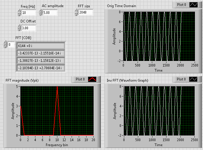

Hi from Sth.Korea. I've currently started using Labview to make ANC system.
As a beginner, I've made quite simple FFT circuit and ran into a problem.
1st, I wanted to create FFT output of the sin wave and create FFt.
2nd, after the FFT, I've tried to reverse the FFT output.
The problem is, when I made reverse form of the FFT, the outcome was quite
different with what I've used as input. The amplitude became really small and I can't figure out why...
Please help me you awesome people around the world~
(3,677 Views)
There are a variety of ways to scale Fourier coefficients. One way is to arrange the forward and reverse formulations to be the same except for the interchange of Time and Frequency domains -- when you do this, you need to normalize both sums by dividing by 1/sqrt(N).  Another (common) way is to ignore N for the forward transform, and divide by N for the Inverse -- if you read the LabVIEW Help for the Inverse FFT, you'll see this is the convention used by LabVIEW.  The numbers you get out are 1/N as big as you "expect" -- you can fix this by rescaling your plot's Y Axis by N (or multiplying your IFFT values by N).
Bob "It's all in the Math" Schor
(3,657 Views)

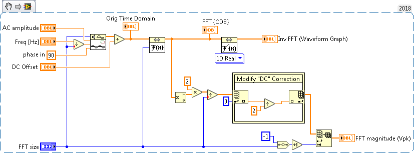

First, I changed and cleaned up your block diagram a little.
Second, you were close. The output of the FFT should feed directly into the InvFFT. No normalization is needed there.

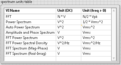

The only place you need to normalize the amplitude (by 2/N) is before you plot the FFT results. The units for the FFT are are N/2*Vpk (for freq > 0). Multiplying N/2*Vpk by 2/N leaves you with Vpk. Note: the DC unit is handled slightly different.
from NI example - FFT and Power Spectrum Units.vi
(3,623 Views)
