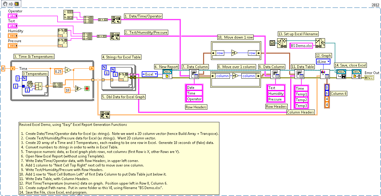

Here is a Snippet, in LabVIEW 2012, of the Excel Demo (the Revised Generate Excel Report Example).  If you have LabVIEW 2012 or more recent, you should be able to drag this into a blank Block Diagram and have the VI "magically" created.  If you have an earlier version of LabVIEW, you can at least see a picture of all the VIs and wiring here, and can open LabVIEW and "build it yourself".  There are no Case statements, so nothing is hidden from view.  In case the image is too small, I also attached the PNG file, which you should be able to open with an Image Viewer and potentially print out for yourself.
