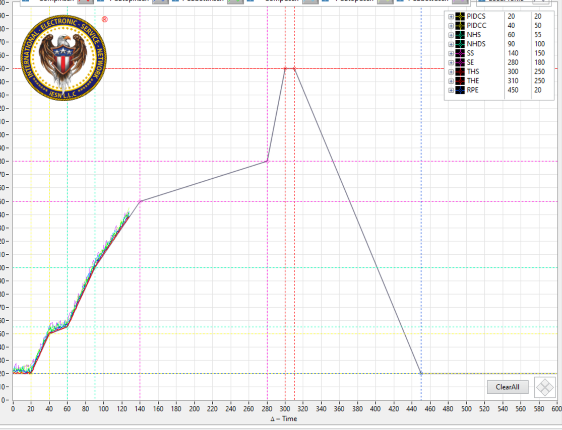

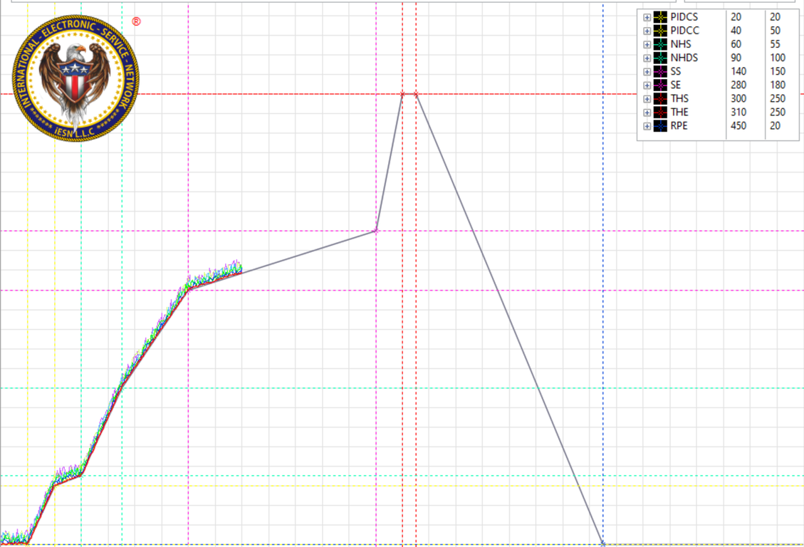

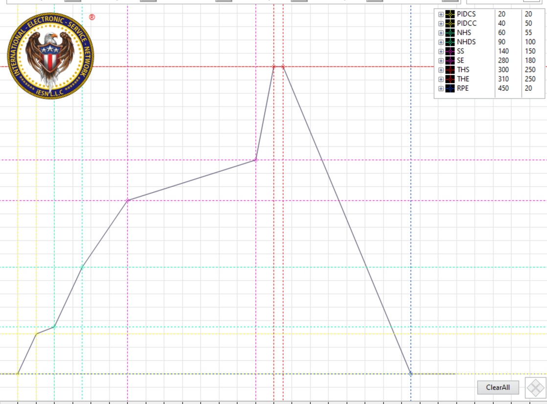

exist a "right  way to plot " a multiple plots on same graph / chart that are not synchronized on time ? you have an image where I use one graph and one chart to do this. I load on XY graph an .csv file to draw a pattern (the gray line), and I use and play with the transparency (completely transparent) an chart to plot in "streaming manner point by point" another 6 plots. I'm wander if can be made it on only one graph or chart. thank you in advance.

The time is the same... 600 seconds but the "pattern - gray line" I load it on start (loaded in a fraction of second at start / open the .csv) as a pattern to compare the next plots that it follow or not the pattern. the plots are plotted with 3Hz. (the rainbow pattern / plots...)
first off all I load this pattern from a .csv file. to be a "theoretical expectation plot"
after that I load first image... I push a button "Start" and are plotting the rainbow plots with 3Hz in the streaming manner.

Using a transparent chart over a XYGraph surely is not the best way. Why not plot all data on this XYGraph? Each plot can contain a different number of  samples!
