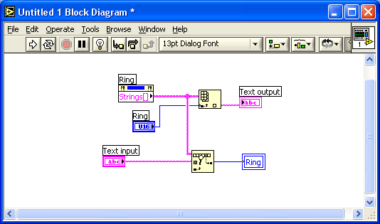

If you are using sequential values in the Text Ring, you can simply do this.
(5,196 Views)
