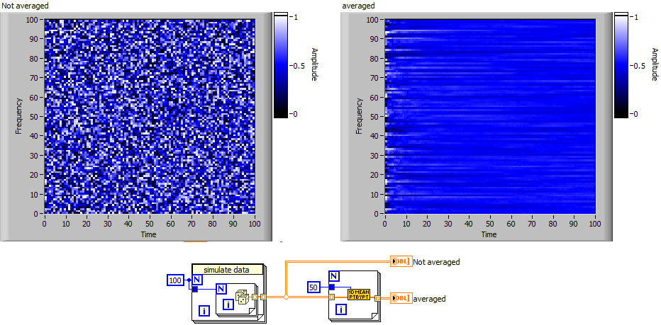

Here's what I had in mind (you can transpose the graphs if desired. Currently rows run along the x-axis). Near x=0, averaging is poor because of limited samples, but later all values are near 0.5 as expected.

Yeah, I think you might have something here. I see didn't use tunnel indexing when I tried, so that explains where I was going wrong and my past query. I am partway through a circular buffer concept that seems to also work, but I'm going to test out your approach properly to compare. I'll report any findings to this thread to spread the knowledge.

@narra_1985 wrote:
I am partway through a circular buffer concept that seems to also work, but I'm going to test out your approach properly to compare. I'll report any findings to this thread to spread the knowledge. .
The 2D array inside my VI is a circular buffer, just implemented fully "in place" where the new data replaces the oldest, keeping track of the insert point. An average does not depend on order, so make sure not to shuffle tons of data around with each iteration.

Hi Alterbach,
Sorry, yes, you are quite right regarding the circular buffer. Also, I am pleased to announce that I managed to come up with the working solution last week and have been busy implementing my little project since then, so excuse me for not publishing the solution as of yet. My solution wasn't quite the same as yours, however, I definitely benefitted from our back and forth (actually you inspired me to think a bit deeper about this than I may otherwise have gone).
...anyway, solution on the way...
