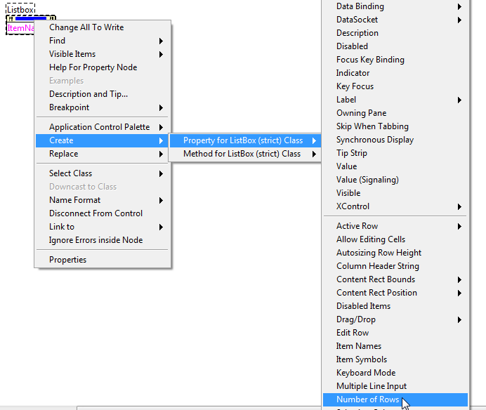

Also, I have 3 paths in this, but there are 5 rows. Is there a way I can automatically update the number of rows to the number of paths. Which means I only need that many rows as the number of paths. I dont want unfilled rows. Thanking You.

Use " Array Size" to get the number of paths in your cluster and then wire this to Property node for Listbox " Number of rows".

Yes I got it, thank you very much for your help
