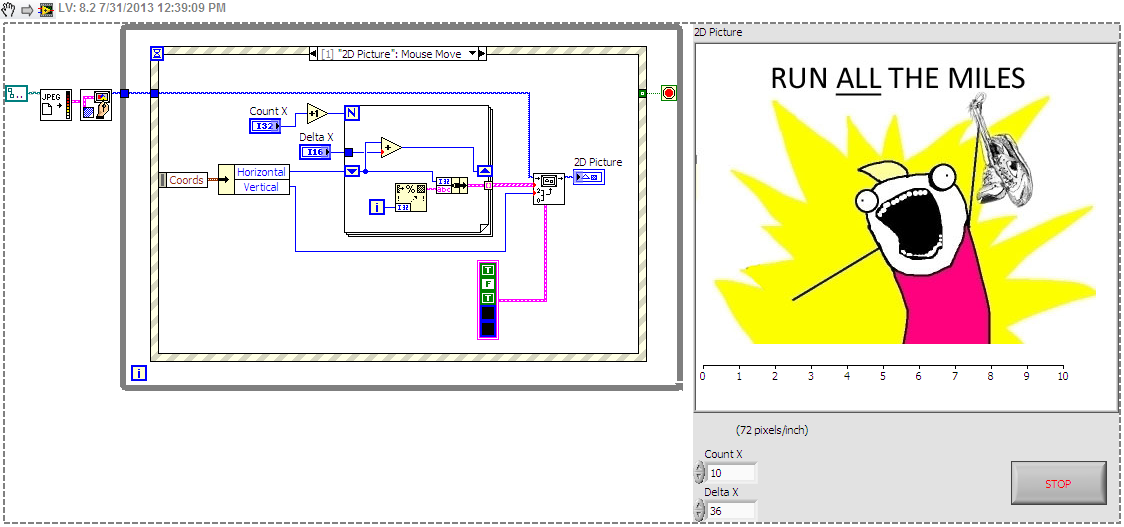

Following up on what Todd_Lesher wrote, here's a rough example of how you can make a scale follow the mouse across a picture.
Jim
