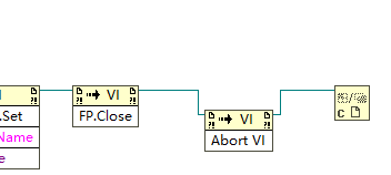

It seems the error happen when you run the subvi twice, try to "abort vi "before close reference.Screenshot 2022-11-15 173948.png

Thank you all.
I fixed the trouble by using exec.state method and terminating the display window surely.
