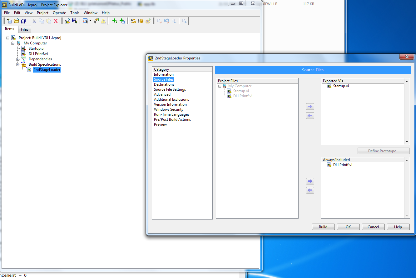

Then create a new Labview project and create a DLL of it (like in this example http://ftp.ni.com/pub/devzone/tut/calllvbuiltdllfromcpp.zip) make sure this contains a function called Startup.vi and that the Labview generated dll is named 2ndStageLoader.dll (dont mind DLLPrintf, it's a debug helper I made)

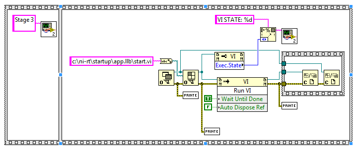

Startup.vi diagram is like follows

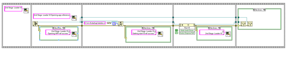

now close the Labview DLL project and create a standalone VI called starter.vi (discard the PRINT E vi, just my debug)

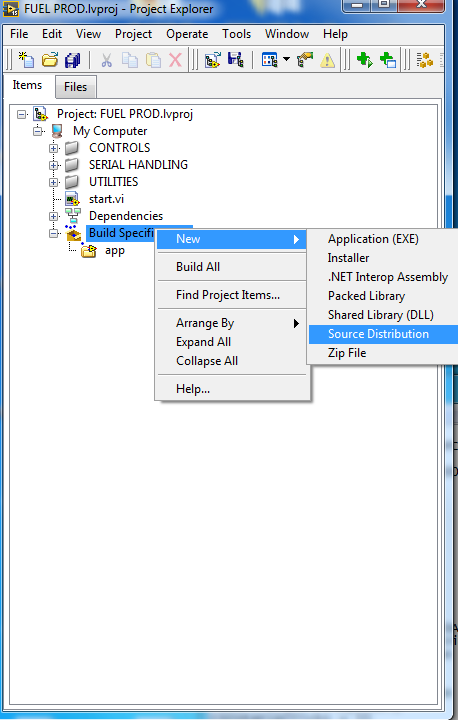

Create a new project and add a source distribution, make sure the source distribution name is app and that the LLB name is going to be app.llb

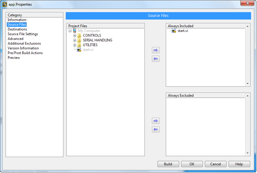

In the source distribution properties make sure that under "Source Files" the start.vi is always included

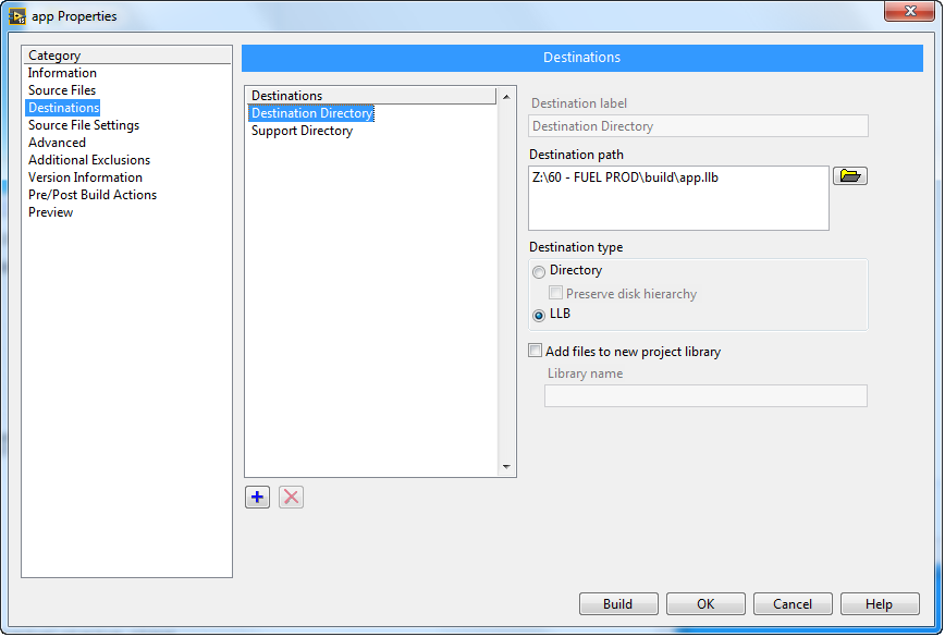

The Destination Directory under Destination is set as LLB
