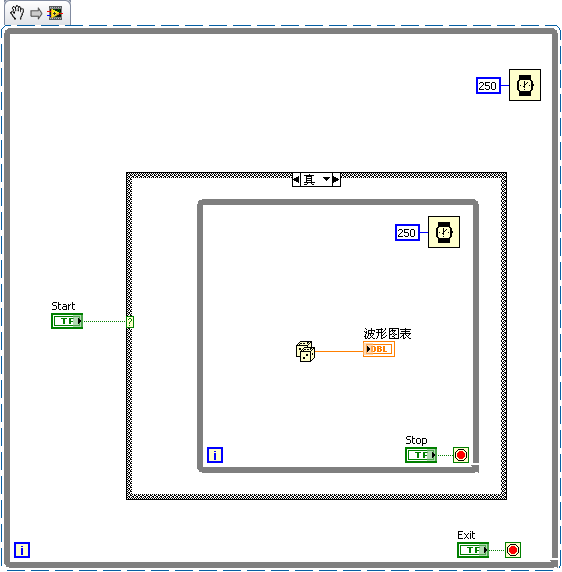

Thank You! but I've known this way. I want toolbar never appear in my application- not before not after execute application,so I must to do run and exit buttons on application.But i do not know how to do it.
(3,941 Views)
You can do it like this
Best Regards
Hu Yu
(3,935 Views)
Thanks!very nice decision. but exit button don't work when application from this VI is executing 😞 and I must close it with task manager.
(3,932 Views)
here
Regards
Guru (CLA)
