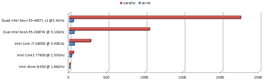

I really would love if you could do a quick benchmark using my program. (requires LabVIEW 2015 runtime engine). This way we can tell how much speedup you can potentially get using highly optimized code.
As you can see from my benchmark table, I get a >16x speedup on my dual 8 core xeon and another user with a quad Xeon (48) got a >43x speedup (even thought hyperthreading was disabled in the bios in this case).
Now somebody needs to buy me a one of these. 😄
Message 7 of 22

I have run the benchmark (but using Labview 2018 runtime engine).
resultat are the same as what I get with my programme : only 1 physical processor is runing... I can see it in resources monitor.
I get best score : 73,78 Hz (serialized) 1204.23 Hz (parallelized) so 16,23x
