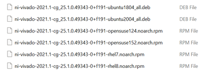

I have downloaded the most recent vivado .deb linux file from here:https://www.ni.com/en/support/downloads/software-products/download.labview-fpga-compilation-tool.htm...

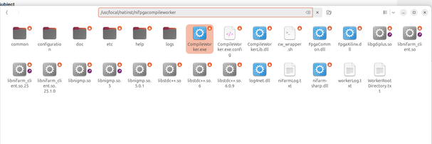

After installing everything. I attempted to run the CompileWorker shortcut that appears in my apps. (running the most recent LTS version of ubuntu 24).
Nothing happens. I install mono and directly attempt to run the executable with mono in the terminal. What is the issue?

Please use the supported Ubuntu 18.04 or 20.04. NI R&D did not validate the unsupported OS version and cannot guarantee that it will function properly.

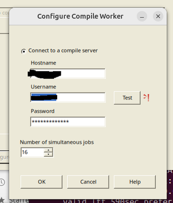

Progress,
Have installed all older dependencies including mono-complete. I am able to run the application. I am still getting a smaller unnamed error. What suggestions do you have?
