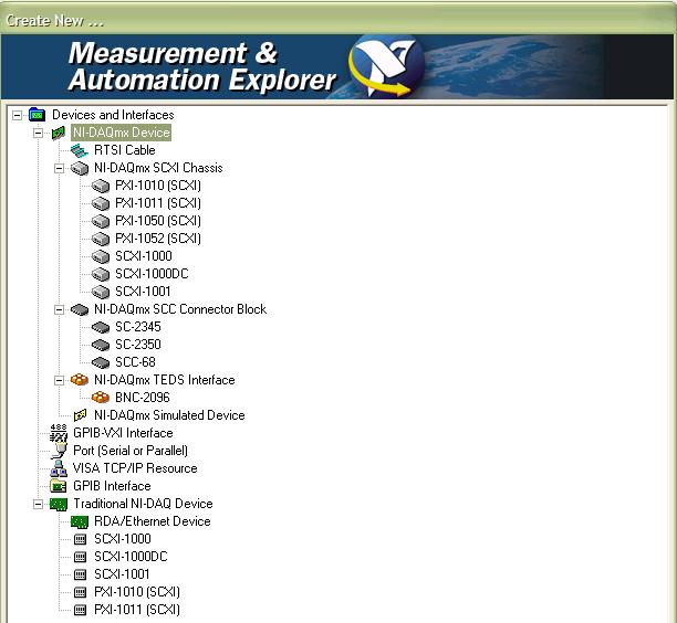

I verified that NI-DAQmx 8.3 was selected when installing from the driver discs.
I see NI-DAQmx when expanding the software listing.
When selecting Devices and Interfaces I do not see NI-DAQmx Devices, only PXI Systems (Unidentified) and Serial & Parallel.
When I right-click on Devices and Interfaces and create new I see the window below.  NI-DAQmx devices is a listing but it's not like the one Dennis posted.
Am I missing something?
Message Edited by davey31415 on 11-27-2009 04:01 PM
Message 12 of 14
(1,154 Views)
I found it, I hadn't selected the simulated device from the list I posted.  Why are all these other devices listed even though I don't have any of them connected?
(RTSI cable, NI-DAQmx SCXI Chassis, NI-DAQmx SCC Connector Block, NI-DAQmx TEDS interface, etc) ?
Message 13 of 14
(1,149 Views)
They are listed because they are all devices that you might have to manually create instead of automatically being detected. For example, you might decide to use a very old DAQ device that is not plug and play compatible.
