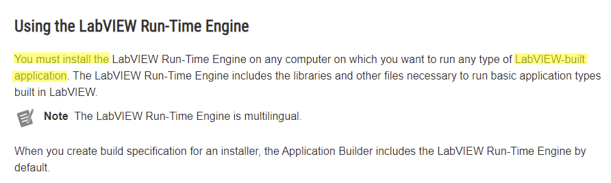

You can exclude the Runtime engine from the installer but in any case, to run an exe built using LabVIEW, you NEED the correct LabVIEW runtime engine installed on the machine, either included in the installer or install separately from the internet or disk, no workaround.
https://www.ni.com/docs/en-US/bundle/labview/page/using-the-labview-run-time-engine.html
