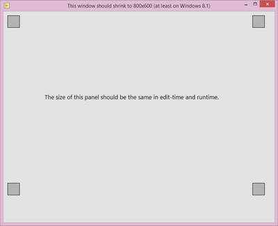

Expected Result:
Panel size equals to values set in VI Properties > Window Run-Time Position (or Minimum Panel Size, as they are equal).
Window shrinks to panel size.
Actual Result:
Panel size equals to Minimum Panel Size + size of hidden items (even though they are hidden):
The window can be shrunk to expected size manually at runtime.

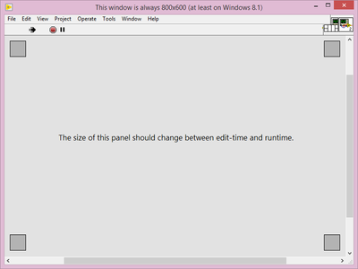

Expected Result:
Total window size stays the same between edit-time and runtime. Panel expands to window size and covers hidden items.
Actual Result:
Both window and panel size stay the same between edit-time and runtime.
If the VI is configured to allow resizing (see TestWindowSameSize1.vi), hidden items appear drawn in a window, but they're not functioning:

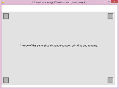

If the VI is configured to restrict resizing (see TestWindowSameSize2.vi), hidden items are hidden properly, but there is a white space in place of them:
