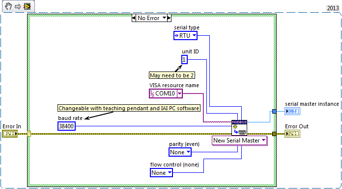

The first part is to connect to the actuator. You will need the Modbus Library that Dennis has linked you too. Check page 15 of the manual "PCON, ACON, SCON, ERC2, ERC3 Serial Communication [Modbus Version] Operation Manual, Seventh Edition" for more information on this.
The unit ID may need to be 2 instead of 1 if you controller switch is set to zero. I think it says in the book "address + 1" but i am not sure. I do not have the controller set up in front of me to check. You may need to connect with the IAI PC software first to make it work, but i am not sure.
