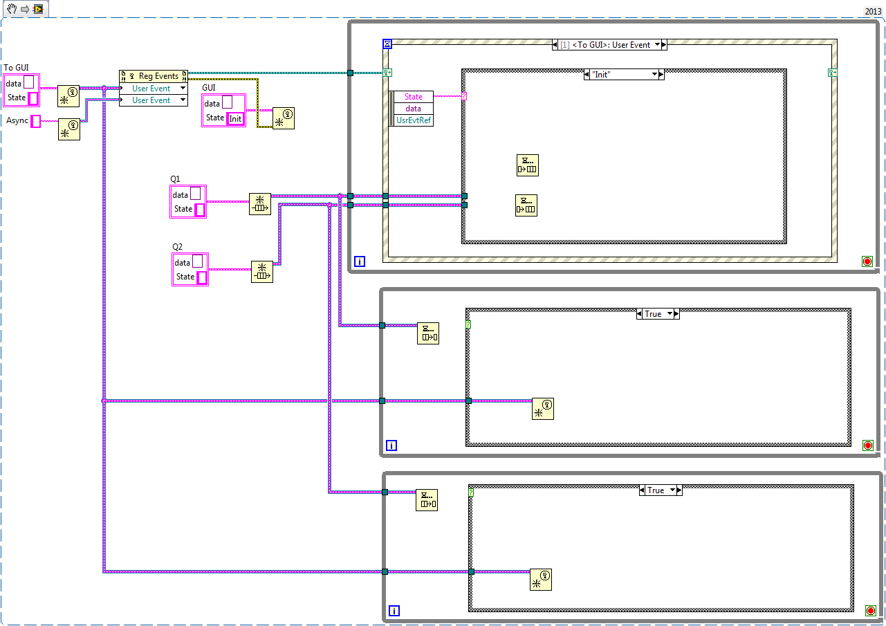

I want to split program into 3 loops: GUI, IO and Processing module.
There is also some async thread running in background working on Listbox.
GUI needs to sent and get data from IO.
So this is what I am thinking:
Async user event for listbox functionality
To GUI user event for Init/shutdown etc and way to sent messages to gui
Queues for other loops
I have written simple concept here:
My intuition says this is a bad idea but couldn't come with something better tooday...
What's wrong with this setup?  I use it all the time.  Just be careful about when you close the references to the queues and user events and be sure to use commands through the queue to close down your queued loops.

I also use this setup.  One thing I do is put all of my Synchronization references and user events into a FGV so I don't have the wires cluttering up the diagram.  Personal preference.

I also put those references in FGV or in Global variable as variant atributes to avoid these annoing vires. My teacher used to put them all into cluster to get only one wire.
My concern is because in GUI I will for sure have have some popups/login/panels/forms and other stuff that blocks this loop and waits for user interaction. When IO writes some important message when Popup is active it won't be serviced until popup is finished by user...

Put the popup in your consumer loop....not in the event structure.

That's what I do.  And then I update the GUI from other threads using User Events that the Event Structure is registered for.  Makes things a lot simpler when you can separate things like that.

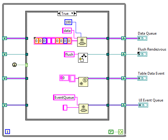

I attached simple concept of what I mean. You are doing it like that?
So I can resize FP bounds and change active tab to allow user see what He needs, keeping all clean in one loop without Popup windows..
But some things trouble me. FP bounds reffer to global screen coordinates. So changing resolution and monitor may cause some problems. So next step would be to get resolution and make it scalable for different resolutions ?
