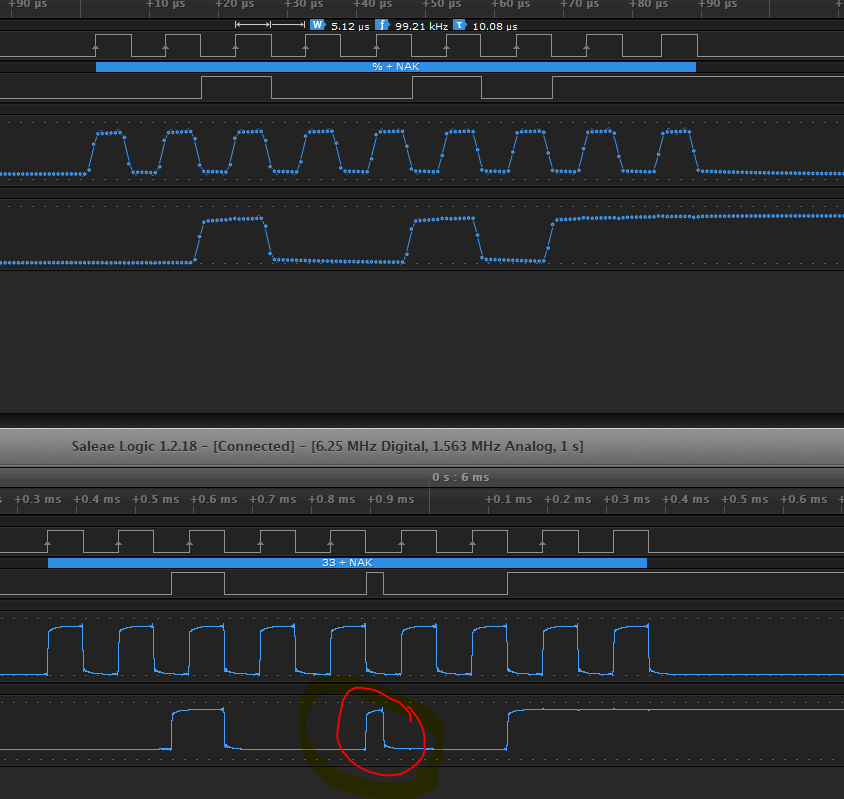

Everithing seems to be setup correctly but the SDA data recieved form slave have someking of issue. Specific data bits are shorter than SCL bits send to slave from LV. See image:
Upper signals were recorded using iC MB3U harware trought USB, lower image is  using Labview FPGA code.
On tle lower image we se marked bit that is too short and Labview cant read it!. Comparing upper image It seems that bit starts to raise in the right moment, but when clock is rising edge, bit already falls down and I cannot read it.
