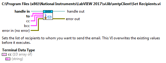

I have had similar trouble with the NI SMTP client before (link). Now I figured out that the recipients from BCC field are exposed in the sent e-mail. Therefore, recipients can see all other recipients. At least in the couple of tests that I did. Nothing much one can do wrong with this test, as you only have to enter one or more recipients in the following VI:
I tested with lv 2015 & 2017 32 bits. I only used my domain smtp server for now.
