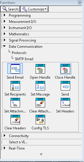

It seems as though the VIs were moved (perhaps changed) in 2013.  Try replacing broken/missing VIs with these:
Another option may be to try to install an older library that (i believe) contains these VIs.  (I have not installed these so I cannot guarantee anything).
Windows: http://www.ni.com/download/labview-internet-toolkit-2012/3122/en/
Mac: http://www.ni.com/download/labview-internet-toolkit-2012/3123/en/
Linux: http://www.ni.com/download/labview-internet-toolkit-2012/3459/en/
